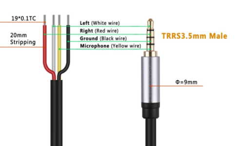

Is this what you're looking for?

Not what I have. I have headphone wires one red, one ground; one white,one ground. And the part with the mic that I want to put on.
Right I wouldn't expect it to be exactly the same, I mean this is just some random diagram online. But let's say, If one was going to get a 3.5 mm jack and want to wire so that when plugged into a 3.5 mm port and have it work, they might want to know a few things, and maybe have the right parts. A four point 3.5 mm jack, when the most common type is 3 section. They could want to know which wire needs to go to which of those sections on that jack. Which location is for the right, left the left and mic the mic. color doesn't change this.
Anyway, this would be how that plug would need to be configured so that it would work. Now your wires may be turquoise, purple, lavender and periwinkle but figuring out which is the common, which is for the left and which is for the right and then were a mic might be added. A diagram like this would let them know where these. Blue, black or yellow, the right earphone wire is still the right earphone wire.

Yessss, that's exactly what I'm trying to say . Just didn't know how.
With that being said... Does anyone have a diagram for the correct way to wire everything the right way. I have:
L & R earbuds, wire, little mic box thing, and a 4 point or section Jack.
I think that's all I need., just missing the sequence of the wires and where to (solder)* thank you VID JUNKIE. LOL
