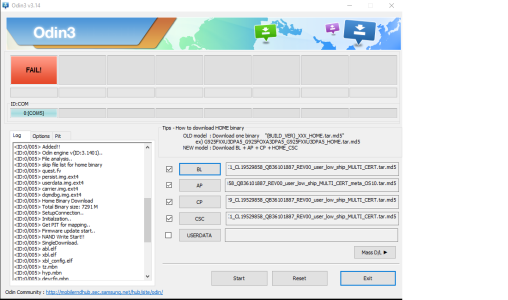

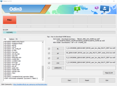

I then came across Odin, which seemed more promising. I'm using a Galaxy S10 SM-G973W. I am from Canada, and got the phone through Fido. I searched for the firmware to use, which I got from sammobile. After a few attempts at refreshing the FW, I am getting a failed message from Odin. I've attached the log messages from Odin. It says FAIL right after storsec.mbn. The version of Odin I've got is 3.14, and the PDA of the firmware I am using is G973WVLS4ETK1.
Attached are pictures of the Odin log.

I still haven't had any luck. I tried on a third computer, and I'm getting the same error. I bought a new USB-C cable, and I'm getting the same error.
I downloaded the firmware that came with my phone, which is this one, G973WVLU2ASIO, from October 2nd 2019. This is the PDA number written on the box of the phone. While running that I am getting a slightly different error.
Any thoughts on this one?

Rooting the phone ends up doing one thing - putting a file named su in a system area of NAND. It has nothing to do with flashing or booting.
The two error messages from Odin say that there's a bad area of NAND (system storage). Nothing you can do but have the motherboard replaced or, if you have an extended warranty (or "protection" plan), have the phone replaced.
