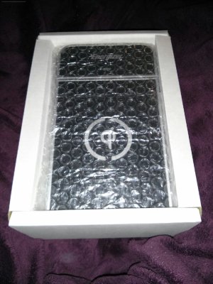

I just got an Energizer wireless charger today:
I have a full body protector (including back protector) on my Nexus 4. I also left the thin plastic protective film of the Energizer charger on it and its charging fine so far.
I'll do some testing by putting things of various thickness including leather and plastic to stimulate various thickness of cases and report back my findings but so far all indications show that the charger will work it a thin-to-moderate-thickness case.
