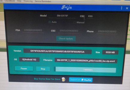

i was updating my s10plus software when a screen came saying downloading do not turn off target odin mode avb fail . i tried to flash it but odin was stuck at vendor.img for several hours. Then i quit odin and then a screen came saying that to recover from smart switch. Then i used a tool to fix the soft brick and now i am in the same downloading screen but this time saying error validating footer. i tried to flash again but am still stuck at vendor.img. i tried a different csc version and that stucks at system.img
PLEASE CAN SOMEONE HELP!!!!!!

Ok let's try this , download samfirm and frija tool from xda forums the latest ones and extract them , put your device model and region and we go from there .

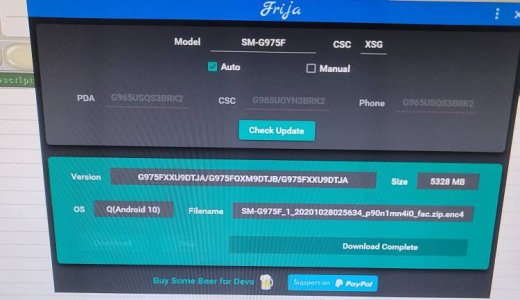

Oh yes i tried it and the download was complete now i have to use odin and flash the firmware?
Extract the firmware after it downloads and put the files in all 4 corresponding slots and leave last slot in odin empty , use home csc in csc slot to avoid factory reset
