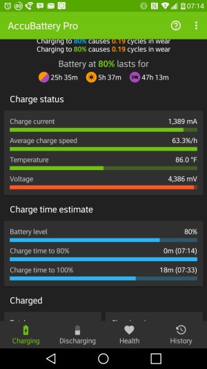

Here's a snapshot of "Accubattery" on my V20 with it at 80%. There is no way that cell is being charged "constant voltage" at 4.386V and ~1,400 ma. Further, there is no way that a proper saturation charge profile from 80-100% would require only 18 minutes to complete. Note that this is a QC3.0 charger and its "average" charge rate during that cycle was just over 2,000mah or just over 63%/hour. It is not possible to run a proper charge profile on a Li chemistry battery and obtain a sub-2-hour complete charge.

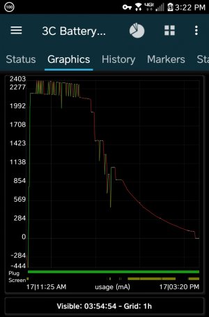

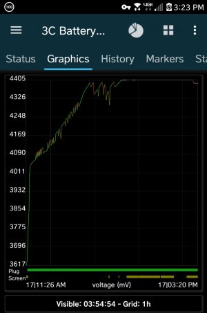

I discharged my iPossible 6,700mAh battery to 18% before charging this time. As you can see by these graphs, the V20 is doing a proper staged charging cycle. It ramps up to a constant current until the voltage approaches the upper limit. Then it starts to taper the current as the voltage reaches 4.4V and is held steady for the saturation phase.
Note that full 4.4V isn't reached until AFTER the meter reaches 100%. Current at 4.4V was down to 895mA. At that point, it still took nearly 2 more hours to finally cut off completely after reaching 100mA. In total, it took about 4 hours to charge with barely using the phone during the bulk charging stage (I did turn it on now and then to clear notifications, then back off, which is why you see the quick dips and spikes). I noted that in the saturation phase with current already tapered, lightly using the phone did not result in a reduction in the charging rate.
AccuBattery reports an estimated capacity of 5,600 mAh and added 4,600 mAh back into the battery during this session. So it seems reasonable to me that the stock battery would take a full charge in the roughly 3 hours recommended with multi-stage charging in the phone.
