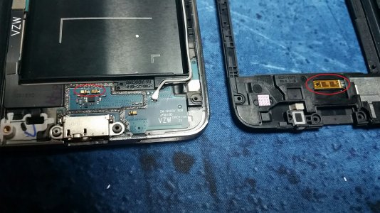

Sometimes the copper pieces here get pushed down too far so they do not connect with their counterparts. taking apart the phone is easy..just the battery and a few screws. Careful when prying off the black plastic backing because a thin strip of adhesive is glued to one of the connectors on the logic board. just take a small screw driver or something pointy and carefully lift on the copper "springs" on the daughter board. put it all back together and start up the phone. Hope this helps. =)
