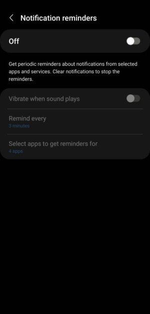

Also check in settings >advanced features >notification >notification reminder not onScreenshot_20220115-222530_Accessibility.jpg

Notifications > Advanced > Wireless Emergency Alerts
