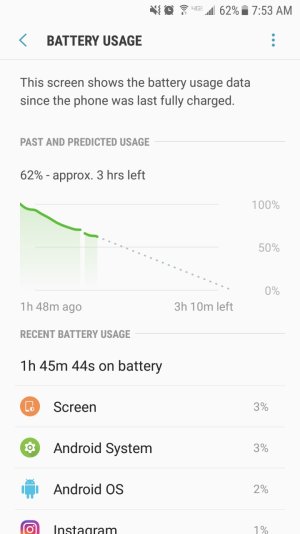

Is anyone having serious battery drain after the nougat update? My phone went from great battery life to awful. I am charging at least twice a day if not more now. I have tried the below steps to troubleshoot and nothing has helped. Even with the phone in Max power saving mode the battery still drains in my pocket.
-Wiping cache partition
-Installing Package Disabler Pro to disable bloatware
-Factory reset
I took it to a Samsung rep at Best Buy and his only suggestion was "wait for a patch, or upgrade to an S8". Below is a screenshot, took it off the charger less than two hours ago with very light use only on Instagram and I only have 3 hours left on the battery? Any help would be appreciated!!!

There have been quite a number of posts complaining of decreased battery life after Nougat on Samsung phones, and not just on the S7, but it's still hard to tell what about the update might be causing this. Check your Location settings -- is GPS turned on? Or Wi-fi Scanning (which is in the Improve Location Accuracy menu)?

My "Location Method" is set to High Accuracy. I do keep my location on because I use Waze everyday for my commute. Should this be on Battery Saving or Phone Only?
My Wi-fi and Bluetooth Scanning are both on, I just switched them to off.
High Accuracy and wi-fi scanning can certainly contribute to battery drain, but if this is always how you've had it set, then the battery usage shouldn't have changed this much.
I typically keep my Location to Battery Saving unless I need it to be more precise, like when I'm using the phone for navigation. I've always wondered how much Waze contributes to battery drain as well. I'm sure there's an option to turn off its constant location and speed reporting, but maybe it's still doing a lot of things in the background.

That is how I always had it set. I will have to see if helps but so far it is still draining. Is it possible my battery has gone bad? I'd hate to tough it out until they send out a patch and my battery still be this awful.
There's always a chance a battery will fail without notice. But it'd be an odd coincidence for it to suddenly start being poor right after a system update.

If you can get by without Snapchat for a few days, see what happens if you uninstall it.

I'll give it a try. I have noticed a slight difference after turning off Wifi and Btooth scanning off. But phone is still draining pretty fast.
