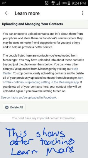

I wish it were that easy. It is true if you go into the messenger settings there is a sync option, but if you "learn more" it explains that it is the same thing as in the FB app, just an upload of your own phone contacts to FB servers.

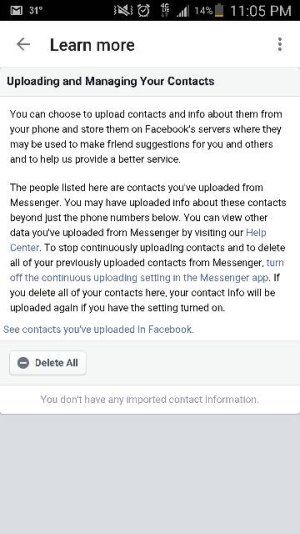

Facebook contacts are now being synced through the Messenger app.

Like the previous comment, no this is not the answer. If you click/touch the "learn more" it shows that it is just an upload option, not a sync.
