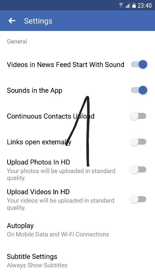

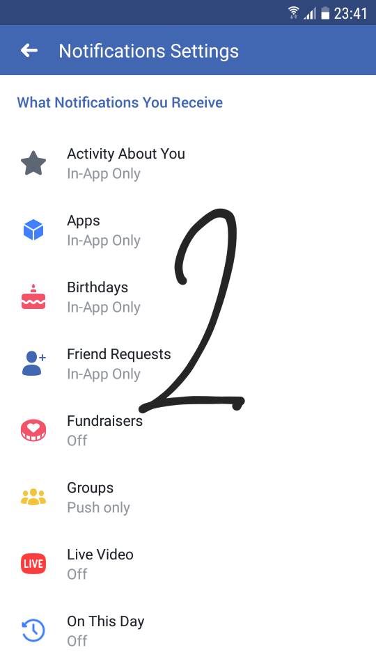

I did everythink you said, didn' solve it. And how did you think of removing your phone number number @Momenol ? :D im glad you solve it for yourself. @Technot2 im using galaxy s7 and facebook app comea preinstalled and cant be deletes, only disabled. But thats not solution, having app that doesnt work. I want them by default to work like they used to. I have checked notifications and sounds, everything is on. :)

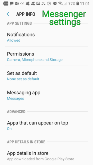

Sorry, but do you think of picture 1 or picture 2. ( i have disable everything i could in picture 2.) I checked messenger app and everything is on ( it is blue). If i did it right like u described it still isnt working :/

Hi, I did what you suggested. Basically I redownloaded the regular Facebook app and disabled push notifications through the app it's self (through the steps you stated) and through the settings on my phone and messenger still works. Thank you for the input.
Sorry, but do you think of picture 1 or picture 2. ( i have disable everything i could in picture 2.) I checked messenger app and everything is on ( it is blue). If i did it right like u described it still isnt working :///uploads.tapatalk-cdn.com/20180123/2901c38dfed46847b281ed97258adafc.jpg//uploads.tapatalk-cdn.com/20180123/d295b76a9acb0a89ac098c2fedad945e.jpg
Image 2 but scroll down more and set push to off. It will say for 5 minutes, 10 minutes etc. But select the very bottom one.

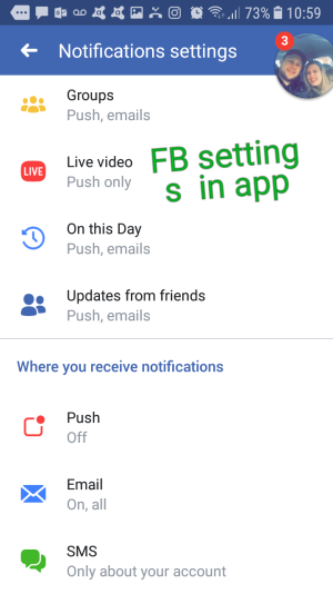

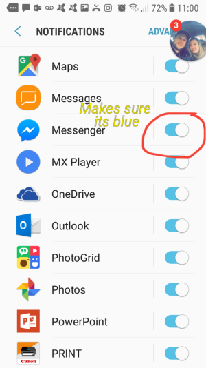

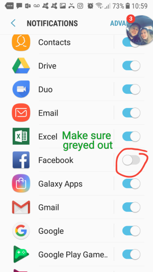

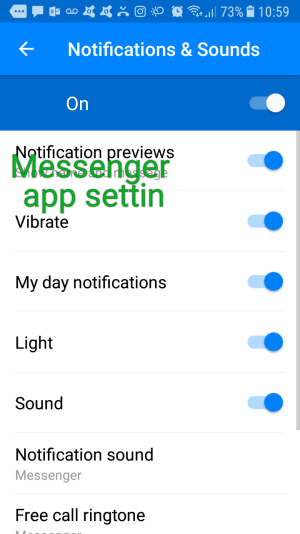

These are my settings for both Facebook messenger and the regular Facebook app. You could try changing it to the same. In image 1 on messenger settings through the app there's more options and they are all set to on. Let me know how you get on. Thanks.
-Kate
