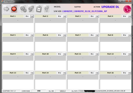

I've done everything I needed to, set to D/L Mode, changed the ports to 41, etc. When I try to start the process, the program sits there at this page, and does not change at all; no progress bar/numbers, nothing (my phone is at the D/L screen but nothing happens, arrows dont move, etc.). I keep hearing about a progress bar though...am I missing something?
EDIT: Never mind, turns out I didn't read the directions closely enough to see that i needed to change the .dll/.tot despite setting them upon opening LG Flash Tool XD Second time I've misread...
I love you so much right now... You also don't need to have anything more than the charge coming from your computer ( I got impatient and it's late).

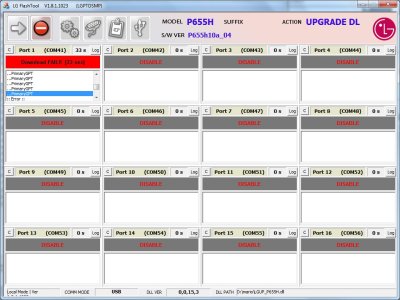

Can you help me un brick my lg g2 vs980? its a hard brick. i cant get it into download mode. i have lg flash tool and drivers
. i have the zip and tot files for stock firmware. i tried to use ubuntu to flash the images back but couldnt get ubuntu to ever boot from cd or usb drive.:(
anyone can help me? the phone stucks in bootloader and kdz has got error w param 100 l param 64 and lg flash tool give me this:
