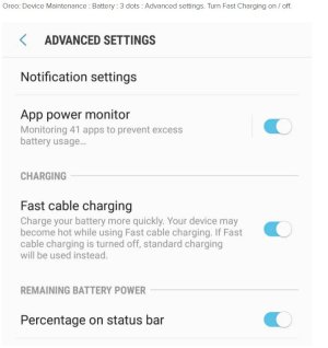

I had the same problem with the S8 and aukey type C cable after installing an OS samsung update but solved it.
if fast charging is not working with 3rd party cables on the S8/S9... sometimes it is due to upgrading the android OS update or wiping the cache partition
1) disconnect the cable
2) go to settings battery , press the 3 dots at the upper right corner
3) turn off fast cable charging option
4) plug in the cable
5) disconnect the cable
6) go to the same settings again and enable fast cable charging option
7) plug in the cable
It should work now
