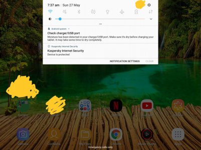

After Oreo(8.0) update, fast charging does not work for the galaxy tab s3 & sometimes it also shows this notification - "MOISTURE HAS BEEN DETECTED IN YOUR CHARGER/USB PORT". NO, THIS IS NOT A CABLE ISSUE SO PLEASE DONT BOTHER TRYING TO TELL ME TO CHECK THAT. Everone try to say that but the cable isnt the problem as i already bought new charger & cable. I think problem is in this latest software update, my tab is just 5 months old, to my knowledge nobody has a fix to this, so here i am complaining.
clearing the cache does not work, factory reset does not work. neither tablet is rooted. fast charging worked fine on ver 7.0. Can someone please tell if anyone also encountering this kind of problem ?

Yeah it was showing fast charging before but after the update it only shows normal charging, sometimes as soon as i plugin charger it show fast charging but instantly it automatically changes to normal charging mode. I dont understand what am i supposed to do
