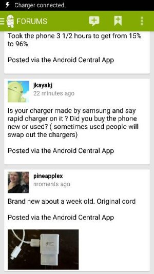

Is your charger made by samsung and say rapid charger on it ? Did you buy the phone new or used? ( sometimes used people will swap out the chargers)
Brand new about a week old. Original cord
All it says is charger connected

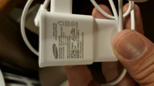

It should say adaptive fast charging on the charger along with Samsung. Is so maybe there is a problem with the phone or charger. I could not find any setting on the phone that would change the charging speed.
