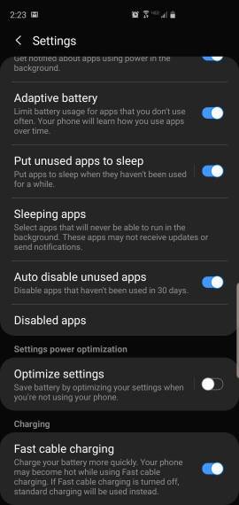

I only see a setting for fast cable charging.
Under Battery Settings they are back to back. Right under Fast Cable Charging is Fast Wireless Charging, at least on t-mobile.
I guess there is no setting on Verizon. I hope that doesn't mean it doesn't support. I have wireless chargers but 1 is normal charging and the other is only fast charge compatible with Pixel.
