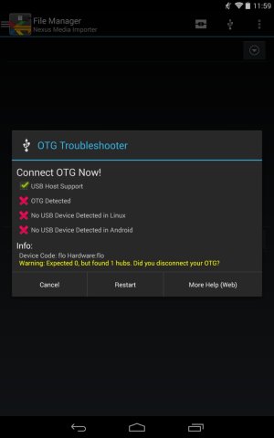

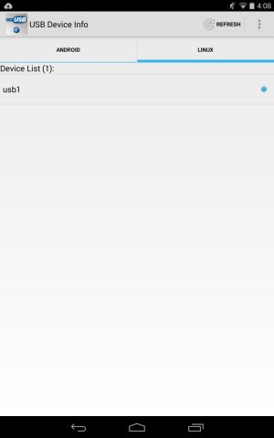

Hi,
I'm looking for some help on deciding whether or not to open a return case for a Nexus 7 2nd gen (4.4 KitKat) I just bought off eBay. It was listed as perfect condition with no returns accepted and when I received it, the Nexus looked like it hadn't even been taken out of the plastic wrap but after using it for a few days, I have run into issues when trying to connect to devices. I've got an iMac running 10.6.8 and a Mac mini running 10.10 and neither is picking up my Nexus with Android File Transfer. Also, the Nexus is also not picking up a micro usb flash drive with Nexus Media Importer (the paid version) but USB Device Info does show the Nexus is picking up a USB device.
Here are a few screenshots:
I contacted NMI and was told it might be a problem with the Nexus 7. The flash drive is working just fine and I've tried pretty much everything to get the flash drive to work with NMI. However, looking around, it sounds like this is a common problem so I'm not sure if it really is a problem and a reason to open a case on eBay.

I'm not sure what happened to your screenshots (I'm not seeing them in the Tapatalk app) but it's possible that there's something wrong with the N7. Mine worked fine with NMI and a USB-on-the-go cable and a HDD.
Do you have USB Debugging enabled?
Does the N7 think that it's connected to your computer? (PTP or MTP notification?)

Thanks for the reply. I don't know what happened with the screenshots, they were working before. I've uploaded them on ImageShack. I can't post links so I'm going to try to add the screenshots again using the url:
And I tried the debugging thing too as well as the MTP and Camera settings, tried using 3 different cables, etc.. I talked to Google support and they had me try a whole bunch of stuff. The tablet doesn't recognize it's connected to the Mac's I have either. Nothing shows up on the Notification bar. I also ended up opening a return case and am talking to the seller so I actually wanted to close this thread but there's no way to do that. I don't know if this is fair to the seller?
