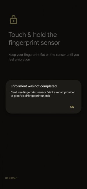

I have Asurion "insurance" on my Verizon P6 Pro. Last weekend I dropped the phone and in the lower left corner was an impact crack and a hairline crack on the front glass on the left side. I set up an appointments with an "Asurion certified UBreakiFix place. I just got my P6 Pro back, yay! I go to unlock the phone by entering the pin code, then lock the phone and attempt to unlock it with my fingerprint, uh oh! I cant unlock the phone with my fingerprint. The phone instructs me to go to: g.co/pixel/fingerpringunlock. I go into my settings to get to the portion where you are supposed to register your print and instead it tells me (see attached image) Am I screwed? Or can I fix this?

I agree with the above post. It sounds like something is not correct with the repair, and I would take it to them and show them that it's not right.

What it will likely give you is the fingerprint sensor reset tool... You have to run this after a display replacement in order to reactivate the fingerprint sensor. However, the unfortunate news as you also have to factory reset the phone.
Do you seriously think I wouldn’t have gone to the suggested website?!:confused: It's just the walk through website that tells you how your data is stored and whatnot.

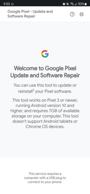

So I called Asurion and they told me to go back to the place, turns out they "forgot" to recalibrate the fingerprint sensor/scanner. A different guy was able to get the process set up within 10 minutes. Had I known that's 2hat it was I could have done it myself.
Seems that should be something the website that you were referred to should have covered as well. At least the problem is fixed.
Funny you link that, I found the same article AFTER the FPS was fixed again.

I figured it out, was not easy getting the drivers set. As the time stamp shows I was at it for about 1 1/2 hours. How much do those Asurion techs get paid maybe I should apply!
