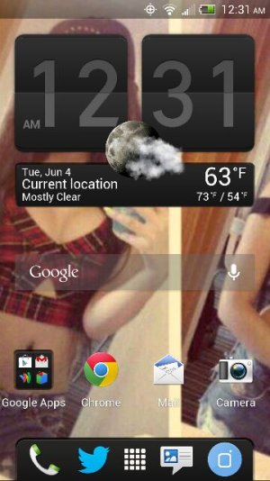

My Rezound weather/clock widget simply stops displays "current location" in lieu of my town name. This always happens under my house Wifi,but not under 3G or 4G LTE. I will periodically get the pop up message "Unable to contact location services to update your weather location".I'm glad I'm not the only one frustrated by this glitch.
