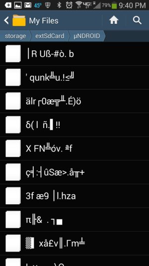

Well, I'm getting tired of the Note 3 very quickly. I initially had an ADATA 32gb class 10 SD card. That was getting corrupted constantly. Then I got a 32gb Sandisk Ultra UHS Class 1 /Class 10 card. It was OK for a short time, but now, I'm getting corruption again.
I tried downloading an app that needed space on the SD card, but during the installation, got an error that the files couldn't be created on the SD card.
I checked the SD card and a few JPEG images are corrupted. There was a folder named "Android". I'm not sure what was in there, but this is what it looks like now:
Note that the "A" in Android is now the Greek letter "mu".
Am I the only person getting this kind of corruption? Does anyone have an idea why this is happening?

I haven't seen this being a wide spread issue. Might want to get with Samsung. Or perhaps Verizon. I assume you are past the 14 day trial period.

RAM is random access memory aka short term memory where it keeps bits of data for multitasking etc. Flash memory is what you're saving to. Seems like your card is bad. Try formatting it first and if that doesn't work I'd swap it out.
I agree you'll never have these problems on an idevice but you'll never have a micro sd slot either :)
I've had mSD issues with Sandisk Ultra cards in both my old S4 and old AT&T Note 8 (sold both). I've had no such problems with them in my Note 3, current Note 8.0, or this Note 10.1.
from a '14 Note 10.1
Bert - I've never seen your situation. There are others here who have a lot more Anrdroid experience than I though.
I'd probably suggest a hard reset, and getting the update (build MJ7) first. Maybe this works. If not, painful as it may be, I'd take the Note to Vz, and explain this has happened to 2 separate cards from different manufacturers. (They will want to blame the card, doubtful since it's happened to twice.) Then I'd probably push for a replacement Note.

Well, it's been almost 2 weeks without a problem. I had removed a "backup" app that I thought might be causing the problem, as it was writting a lot to the SD card. It seemed to help for a while, but the corruption is back again.
I have a very large game app (The Room) that installs itself on the SD card, and I'm assuming it writes to the SD card to save data. I just went to run it, and I got the "App not installed" message. I looked at the SD card and there's another corrupt folder (the name starts with the "mu" character) that has about 100 files in where all of the names are made up of extended ASCII chars, and the Lost.dir folder has four files in it.
I'm guessing that whatever is causing this, occurs when writes occur to the SD card. Somehow, the OS doesn't know how to write to the file system on the SD card without corrupting it.
I'll try going to Verizon to see what they'll do/recommend.
