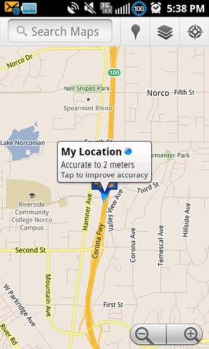

Im on froyo now, and I get quick gps locks, and they are fairly accurate, and everything appears to work, but my accuracy seems consistantly off. It will report a small accuracy, say several feet at bests (depends on how many sat i can see), but when you use the Satellite layer in google maps or in my geocache program (c:geo, which I highly recommend for any geocachers out there) the marker for my location is much further away than I really am, perhaps up to 80 feet I would estimate. The aerial images are very good (as are most areas), and you can zoom in very close to see the difference between where I am standing, and where the gps says I am. When I was back on eclair stock, the marker was always right on, every time. Its like there is a incorrect (or unadjusted?) "shift" in the coordinate system, if you get my meaning. Ive tried option #3 for gps fixes, but no change. Any suggestions? Im curious about #4, but dont know if it will help or not.

I'll do a test for you in a bit...

Not that it would be an authoritative test, but I performed recommendation #4 and it worked for me. Prior to it, I had no ability to get a GPS fix on my location, it would just seek forever. Afterwards, it was very quick. I have not done a test for accuracy of the location. I can test at least what I am getting and let you know. Would it be good enough to stand outside at an intersection, get a FIX, open maps, and compare how far the map's location is to what the stated accuracy is?
(also... I saw a screen of the post above yours -- that is NOT GPS Status app, AFAIK. can I get a similar accuracy reading from GPS Status app?)
Let me know
@Mobius360 -- What is the application you are using to show your GPS accuracy? I have installed GPS status, as per one of the other suggested fixes (to reset GPS), and I don't think that is one of the screens from the GPS Status app.
Thanks
If you are talking about the top "blue" screen, the program is called GPS Test
how did you pull up that screen in the app? i have the app but im not very good with it
