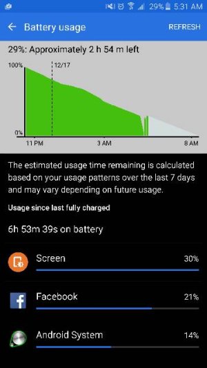

Sudden power drain on my note 5 (first time now) and when i plug the charger it goes back up to 30 from 0 in no time? This is extremely frustrating.

Have you tried a reboot? It could be just a temporary bad battery reporting by the OS.
Already did that, and i deleted the cache partition as well. I charged it to 100 percent and will continue using it for the rest od the day to see if the issue is still presistent. I will be taking screen shots every 10% drop in power, to monitor how much it takes the battery to drain before reaching 26% (at exactly 26% it drops instantly).
I'd suggest a factory reset or a battery recalibration tool from the play store. If that doesn't work I'd definitely take it in or request a replacement
you need to re-calibrate it. Charge it to 90+%, use it until it reaches to 10%, charge up again.

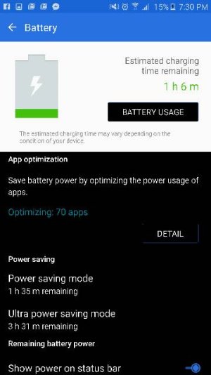

Already charged it to 100% and been using my note 5 heavily since then. From my point of view, I can conclude that there is nothing wrong with the battery, because honestly it has outdone itself 6+ hours of screen ontime chatting checking facebook and video playing (480p quality on mx. That was till it got to 23 % this time and started dropping insanely). There is definitely something wrong with the software not recognizing accurately how much juice left till it is too late. I am currently charging it up again, but I dont want to waste any more time testing it. So should I just leave it plugged in untill 100% and remove it directly afterwards or should i leave it there?

Do another wipe cache partition from the android boot screen, reboot phone, then go into settings/advanced calling and activate advanced calling (it's free), then turn it on for voice and video. This literally has added hours to my note 5 battery life. When I first got the phone a month ago, I had similar issues (4 hour battery life from 100 percent, extremely overheating, ect.) Now my phone NEVER gets hot. At all. My battery will last almost 10 hours now, and that's with heavy usage. Hope this helps.
Usually I see everyone give the advice to actually turn Advanced Calling OFF because it causes other issues. You're the first person I've seen who suggested turning it ON.
I know, that's what everyone on this forum seems to be saying, but I found this fix from another forum and it seriously works. No, the advanced calling doesn't seem to make the calls any clearer like it's supposed to, but my battery lasts all day now. Don't believe me? Try it yourself. I should also clarify, when my battery was draining in 4 hours it was due to cell standby. It'd say 80 percent of battery was due to that. Now cell standby doesn't even show on my battery report.
