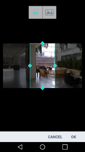

With stock - press and hold on an open area of your home screen. Then at the bottom select 'wallpapers' followed by 'gallery'. Choose the photo you want then at the top you should have the option for 1 photo or multiple (image attached). That should give you a non-scrolling wallpaper.
It does but it chops the picture to almost nothing. On my S6 it would use the entire pictures resolution with no cropping. Anyway to do that?

If the aspect ratio (length vs width) of the image is wider than your phone screen - as in the picture above - it will have to crop the picture to make it fill the screen. Optimally, your background should be 2560 x 1440 pixels if you want it to fill the whole screen without any cropping, stretching, or black borders. I can try to help out a little bit if you could link to the background you are trying to format, or if you could give an example of the S6 using the entire picture resolution.
