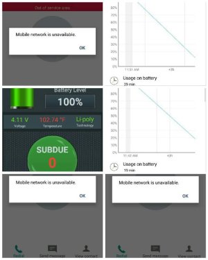

Now the phone is getting a lot hotter than before the restore. Phone is only hot when the sim card is installed and connected to the mobile network (AT&T). Along with it getting hot, the battery life is abyssmal compared to before. Pre-restore, I would get 1.5 days of moderate use per full charge with the mobile network. Now if I'm using the phone or not, the full battery lasts less than 4 hours. Phone will not send or receive text messages right away if at all. Phone calls will disconnect while ringing ("mobile network is not available" or similar) and cannot connect calls sometimes.

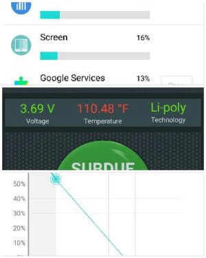

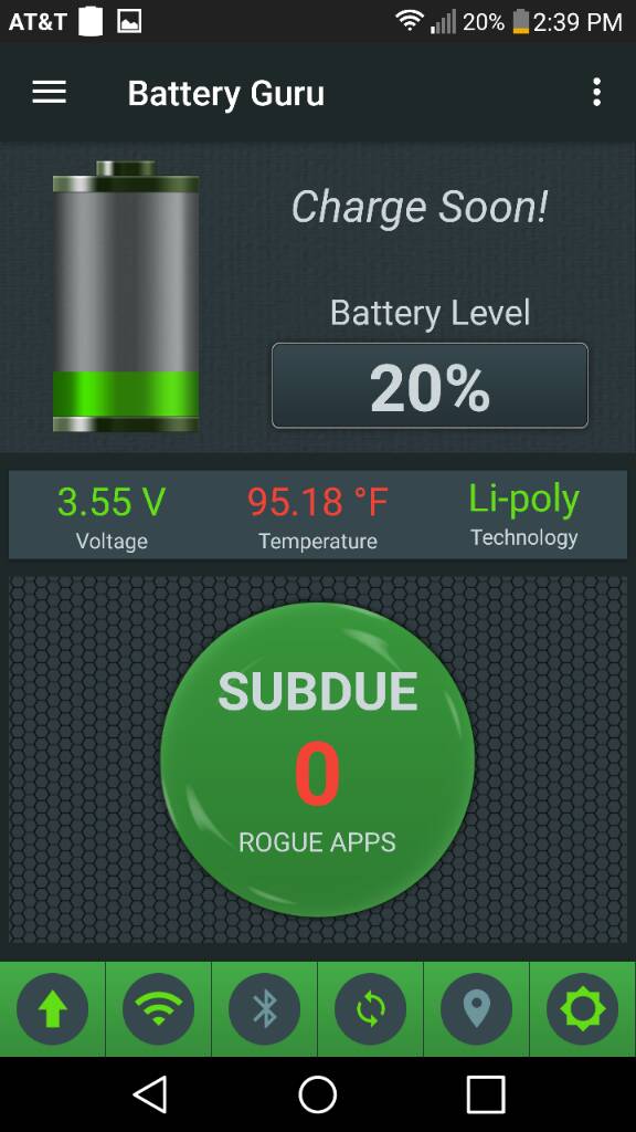

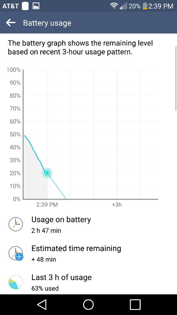

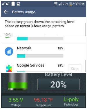

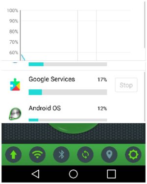

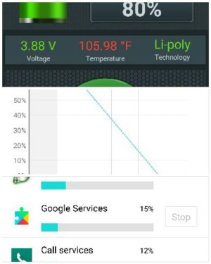

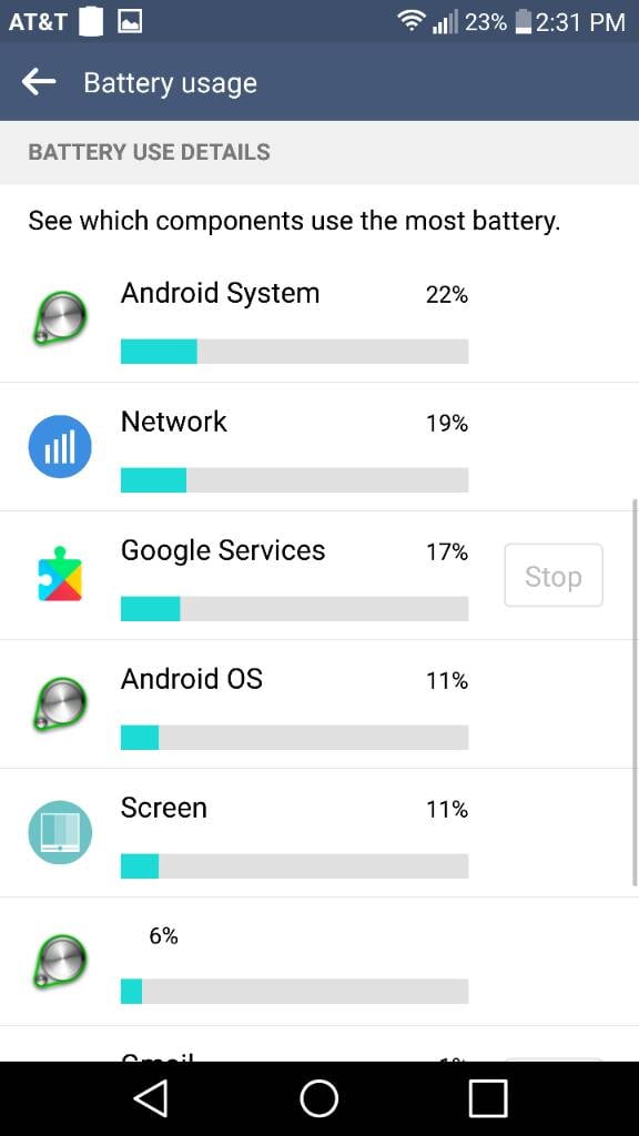

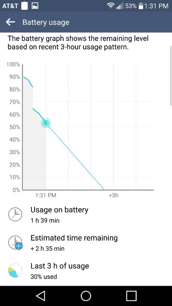

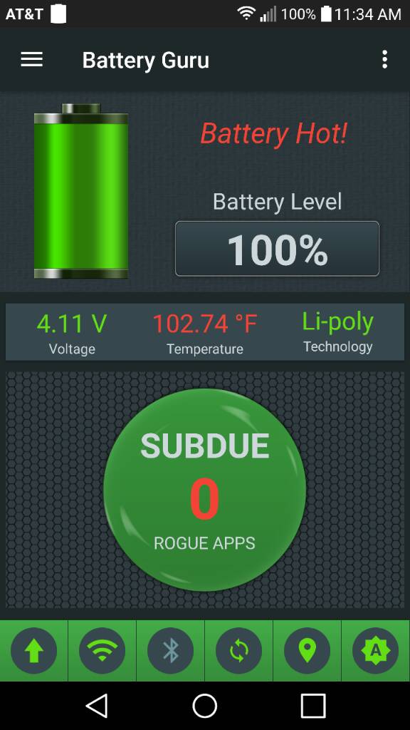

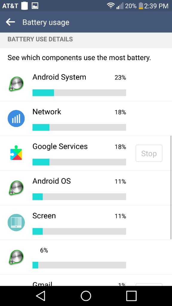

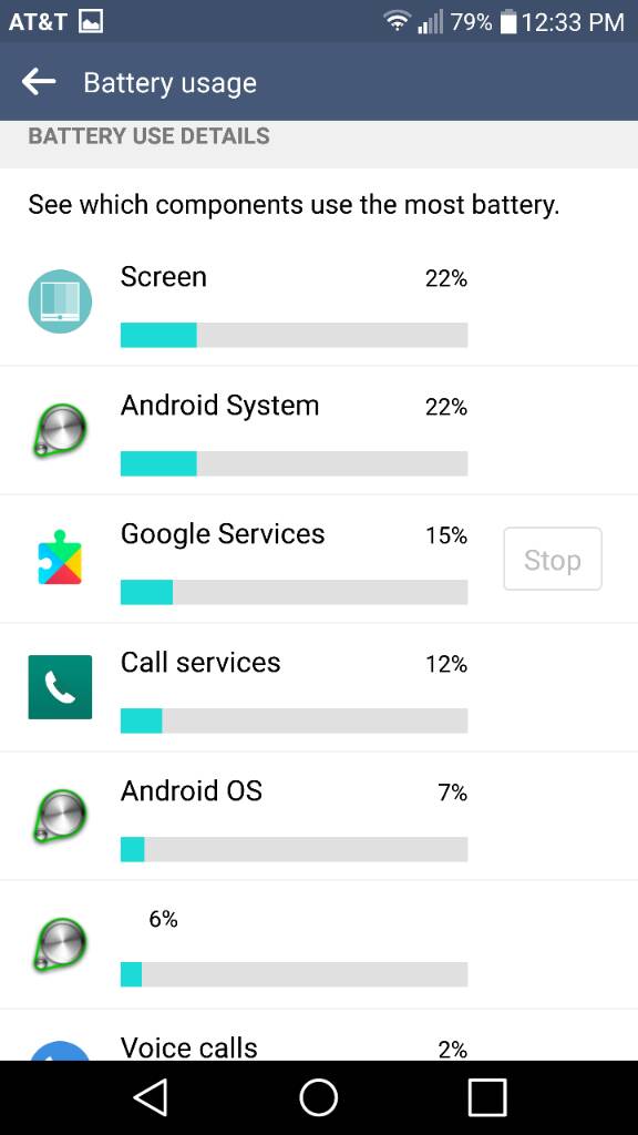

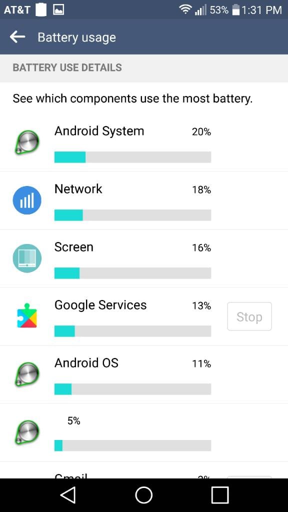

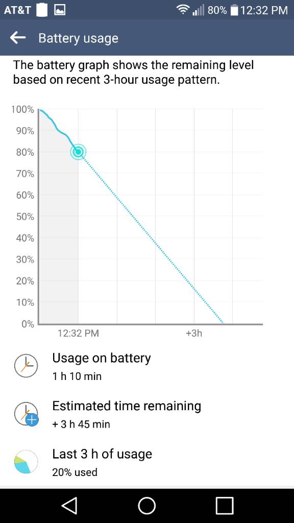

Welcome to Android Central! What kind of cell signal strength it the phone reporting? Use it from 100% down to around 20-30%, then show us screenshots of the Settings>Battery menu after tapping the battery graph (so we can see the cell signal strength bar). If the phone is reporting poor signal, that could cause things to get hot as the phone works to compensate.
http://forums.androidcentral.com/ge...ide-how-post-screenshots-android-central.html
Thanks!!! I will be posting screenshots at 100%, 80%, 53%, 30% & 20%.

Do you have a cell signal strength graph? You never have more than 3 bars, and it seems like it's more like 1-2 bars. Network is also a relatively high battery consumer.
