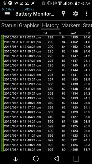

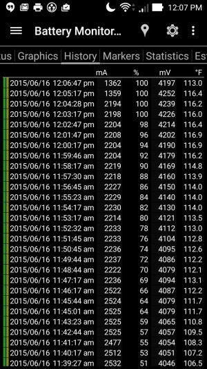

I was using the g4 for basic tasks - browsing, Tapatalk, email, and hangouts and it went up 3-4% in 20 minutes. In comparison, my zf2 went up 41% in the same time. Also when used as navigation the g4 sometimes won't even go up a single percentage in the same time.

Charging is definitely being restricted by heat. LG needs to tweak it. That ZF2 is allowing 4 times the mA at 20 degrees higher temp.
I kind of feel like this "more efficient screen" that LG touted for the G4 is actually less efficient than that of the G3.

Even with it just sitting on the desk with the clock displayed while charging it is noticeably slower to charge.
+1.
The slow charging with the screen on is the most obvious symptom. But keep the phone cool (I used an air conditioner for my test), and it can still charge at about 1500mA with the screen on, at full brightness. My thread with my temperature/charge current testing results:
http://forums.androidcentral.com/lg-g4/540551-slow-charging-apparently-related-temperature-warm-slow.html
The problem is that once the battery reaches about 90F, the phone throttles the charge current down to about 300mA. And in the summer, it doesn't take much at all to get the battery to 90F.
As tourbound129 said, the other phone's battery is 20F warmer, and that phone is *still* allowing 2200mA of charge current.
The stock LG charger for the G4 likely can't achieve that much current even best-case (phone turned off), as it's only a 1.8A charger. But even with that aside, in the summer, the phone won't stay cool enough to allow the ~1500mA charge rate, if you're using the phone, and you have the screen on. It would seem that a software change could relax these rules. Raise the 300mA-charge-throttling temperature, maybe to 110F, something like that.
If you're in the car, and you need to use navigation, then you may not have the option of turning the screen off, etc. And you can see your charge % stay the same, or even drop slowly, which seems pretty disappointing to me.
