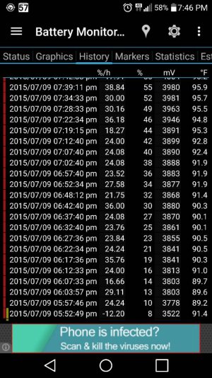

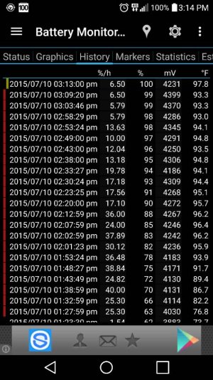

This one is sold in amazon by Landfox for about $8 shipped, not bad for a sticker and pad combo. Took 3 weeks from china to West US.
I'm attaching the charging graphs, 1st time was with the G4 stock charger from 8% to 55%. The 2nd was with the Zero Lemon quick charger from 63 to 100%
Not going to get in depth but it works. I put some scotch tape under the contacts to the left of battery cover so it could touch the ones on the phone. Temperature rises on the phone itself and the pad gets real hot. Cool thing is it charges with my case on.
One weird happenstance was I put it on the pad last night using the stock G4 charger and it went from 25% but stopped at 44% and 103* after about 2 hours. So I woke up to it at about 43% and not charging. Safety feature for high Temps? I don't know
Two negatives, if it charges to 100%, no apps open. I have to power down and then turn on again. The other is it is super duper slow, which is fine since it's an overnight charger for me.
