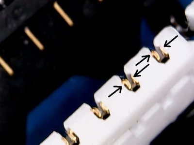

The battery connector is surface mounted, no need to remove the mainboard to do the re solder work. I am not sure how well your skill of soldering, but to make sure reheat it again with solder flux.
1- You may need to resolder the black male battery connector again but try the white female connector first.
2- Make sure to fix the female white battery connector with 6 wires, loose connection also is the source of problem
Read this post to understand how they are connected and fix the loose connection
http://forums.androidcentral.com/sa...screen-flickering-problems-4.html#post4549435
Samsung uses silver conductive glue to fix this loose connection. Try to fix it first before resoldering your battery connector.

That is the way Samsung fix loose battery connection, it'll a little hard to disconnect the battery but I have to wiggle a to take out the connector.
I notice they are using this glue recently instead of cutting the plastic off and solder 4 wires ( 2 possitive: red wires, 2 negative: black wires ) directly to the pins of black battery connector ( they did when a tablet returned for RMA ).
However, you don't need to use conductive glue, just adjust the opening tips closer, they will make good contact .

Obvious your battery connector don't make good solid connection: one battery is charging, other is not: your female battery connector is the problem.
Both batteries are the same, your black male battery connector has cracked solder joints, need to be re soldered.
I usually fix both connectors as the female connector is making loose contact if it's disconnected so often, male connector tends to crack due to flexibility of Samsung tablets ( mainboard and the frame sit on top of the LCD ).
