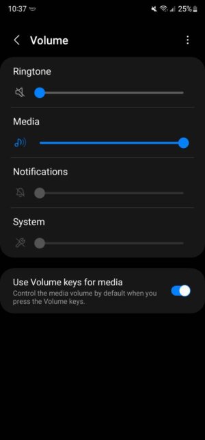

Can you post a screenshot from your settings>sounds and vibration>volume tap Screenshot_20220612-223715_Settings.jpg
