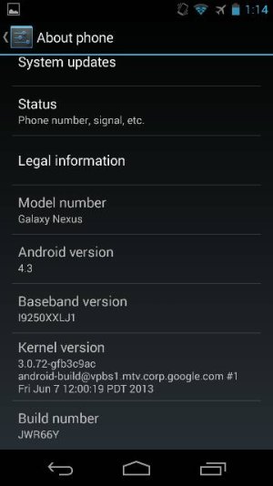

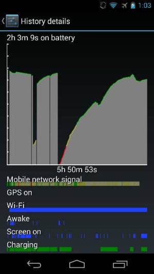

I have a problem with my galaxy nexus. 5 months ago, i brought the phone and i saw that the battery didnt go more then 99%. After sometime, it was 98% after, 94℅, after 90%, after 80% after 70% and i decided to change my battery. When I changed it, it became worst. It was at 45%. I was using it and it was stuck at 15% so i decided to change my usb port. Since i changed it, its stuck at like 70-80% (charging the whole night) i tried the factory data reset, safe mode, wipe cache, i manually update it to 4.3 (by using google) and now i dont know what to do. Sometime when i unplug the phone, the screen froze and reboot and never turn on if i dont plug it and sometime, the charging notification on the top right of the screen disappear even when its connected. Thanks for answering me:) i took a screenshoot of my battery stat and my phone details
And i don't have a warranty, i brought it from my friend and the warranty finished.
