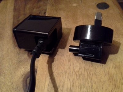

Actually, I believe the meaning is to remove the localised AC adaptor by sliding it out, then plug in an AC radio power cord with a figure 8 plug.
The result will effectively give you an AC extension cord without the bulk.20160820_185911.jpg

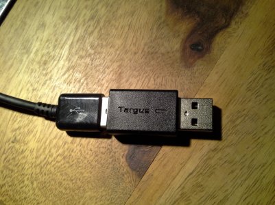

After much testing of a variety of AC and 12VDC adapters, it appears that some Samsung tablets require a proprietary charger or adapter similar to Apple.
All AC adapters I tested gave the red crossed charge icon unless they were Samsung of 2A output capacity.
All 12VDC adapters I tested gave the red crossed charge icon regardless off output capacity (2A & 3A included.
Adding USB extensions did not cause the red cross in any combination, including extra thin cables, with 5 different cables strung together in series. Total length of over 3m still works fine with the correct 2A adapters.
BUT, adding a dongle supplied by Targus gets rid if the red cross for all scenarios!
This came in the "Laptop Car Charger + Phone/Tablet Charge", model # APD046AU
The Targus website actually mentions "iPad or tablet", so should be good for all.
