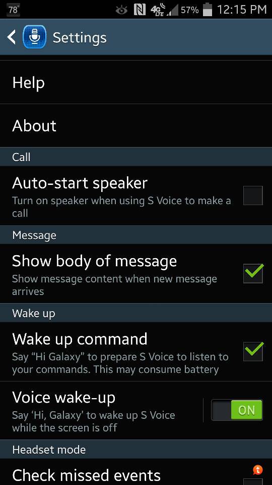

I think I got it! You may have to change your lock screen to "swipe" initially before all this, then change to whatever lock screen you want. I went to s-Voice settings and turned off the Wake Up Command and the Voice wake-up, rebooted, then went back to S-Voice. Some choices came up, choose to have S-Voice wake up in locked mode and screen off and rebooted again. My "Hi Galaxy" feature now works again in pattern lock with screen off. Yay!
Update: I've had to do this several times. I think S Voice needs to be an active app when phone is off so that you can wake it up with Hi Galaxy. Several times I've had to make the choice of enabling S Voice Administrator to control when screen is locked/unlocked. Hopefully, I won't have to keep making these choices, but hey, better than nothing!

Thanks heaps Don Honda #32. I turned off the settings you suggested. Restarted my phone. Reset the same settings and now it works again. Great. Thanks again :)

Double click your home button to bring up S Voice. When it is open, tap the menu button, go into settings, here is the wake setting. There are two wake commands, one for when the screen is off, you have to turn that on also.
