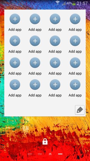

Hello everyone,
I got my Note 3 yesterday and this is my first experience with TouchWiz and I'm having some trouble using lock screen widgets.
I enabled the option to allow multuple widgets, but now I have this annoying favorite apps widget that I just can't seem to remove. Has anyone had this issue?

I don't have one to play with yet but if it's similar to my girlfriends S4 that app comes up when you swipe from right to left in the top region of the lock screen.
Why not just add some apps to that widget and enjoy shortcuts from the lock screen.:D
Just hold your finger on it & drag to the trash can above :)
Cheers, Jon
Doesn't work :P
I've played with the note 3 for a couple of days and to get rid of the fav apps go to the lock screen menu on settings and there is an options to change the fav apps for the camera when you slide from right to left. Hope that helps

There were a lot of nonsense answers above so I skipped past instead of reading all the way thru since I have a Note 3 in hand. The multiple widgets option automatically enables a setting in that submenu. By turning it on you are enabling either Favorite Apps or Camera. Click on the option where you enabled Multiple widgets and select Camera if you don't want that Favorite Apps folder popping up. Once on your lockscreen you should be able to swipe left to right to switch to a left screen that should present with the option to add a custom widget to the lockscreen. Let me know if this makes sense and you were able to figure it out.

Go to the lock screen and slide over to one of the apps, now push that little gear on the bottom right. If that doesn't work keep messing with the damn phone in the lock screen until you open the lock screen menu.
One option is "disable home base", push it and wait (my phone took like 30 seconds to load the next screen). It will now ask it you are sure you want to disable the "home base base". Select HELL YES PLEASE. It will now be gone, anyone who's had this problem knows it is annoying and sucks. Thank God mine's fixed. Hope this helps.
