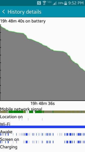

I get very good almost excellent battery life especially when i dont play games, I've also noticed having 3g signal did not adversely affect my battery life...today ive played words with friends pretty heavily i will post battery stats at the end of today...

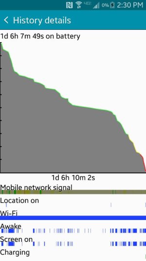

I'm closing in on my two week period....I unplugged my phone at around 1230 today, it was at 100% I'm now at 78%. Granted I don't think I've closed the screen once....does this seem normal or should I maybe look into getting a new one?
I don't know how times show here. Whether it is 30 or 90 minutes you mean you don't need a new battery. You need the GSAM app and to study what it tells you. Everyone on this thread who thinks they have problems with a battery likely have problems with the apps they are using. I had a problem and I figured out which app it was. It's just not mathematically possible to have as many defective batteries or devices as people think there are. Has anyone ever gotten a bad battery for anything else? I have to believe anyone with Android System sucking more juice than Screen does is having an app problem. If you don't want to read all this stuff (not you specifically logik) then swap batteries, see the same thing happen, swap phones, see the same thing happen and THEN get GSAM and study...

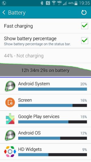

This Is my current stats

So logik, mine with great stats has system and kernel about 2 points apart. Looks like you have something in Android System that's sucking up power. I'd keep looking for that and try to see what it is.
how do you figure out why 'android system' is sucking so much power, and what is the solution?

From several devices now and hundreds of posts I believe Android System should never be higher than screen and certainly not nearly double kernel. I know screen isn't on the one you mentioned. I am thinking of the later one there. It's not scientific and I am not a developer. I just read all this stuff.
How to figure out for me is to look at each app and try to find similar cases outside this forum. XDA is more technical and Google has everything. It's trial and error. Keep figuring out what it isn't until the problem stops.
