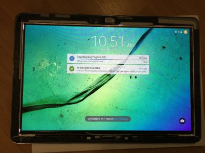

Touchscreen is only around $50 but LCD and touchscreen are glued with Optically Clear Adhesive ( OCA ) film. I think your chance of breaking the LCD is 90% if using heat gun and have no prior experiences
They have special heat plate to heat up the LCD evenly and thin metal wire to separate the touchscreen and LCD. No experience you're more likely will cut or damage LCD flex cables as well as crack the LCD. Even if you can change it without damage to LCD, air bubbles between the two glasses are unavoidable without OCA film.

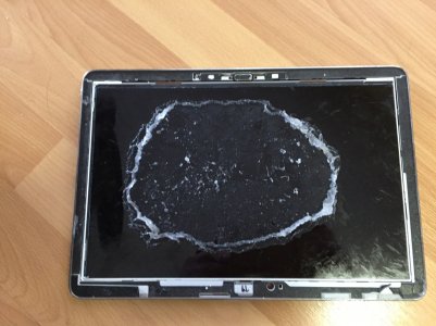

After one hour of labor to heat up and separate the touchscreen, this is a test to make sure the LCD is not cracked or damaged
Then another one hour to remove this clue:

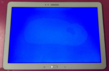

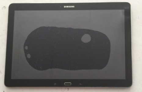

Here is a LCD assembly with new touchscreen without OCA film. I damaged 3 LCDs to learn how to replace the touchscreen.
You can expect spending 3 to 4 hours to finish the replacement.
