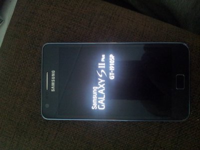

I've got a phone that froze in use and after reboot it just stays in startup screen:
If I take the battery out and replace it after a few minutes and then try to restart it just get's stuck in the same screen.

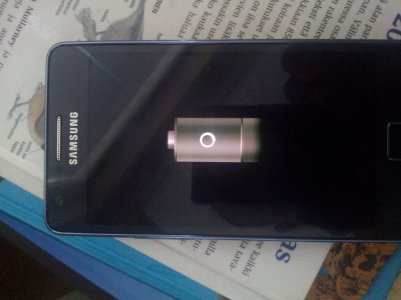

If I take battery out, replace it and stick the charging cord in then it get's stuck in following screen:
