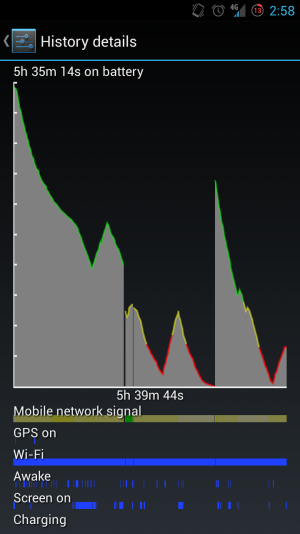

My phone is basically just being incredibly stupid and I have no idea how to fix it. Let the following speak for itself:
This started happening out of nowhere, a couple months back. My phone will lose battery at an incredibly fast rate, then swoop back up (without being plugged in), then fall, etc etc until it hits 0%. I can then turn it back on and it says 50% or what have you, and the same process repeats. These are the things I've tried:

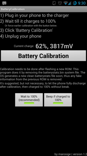

  3. Installed all kinds of battery helpers and battery recalibration apps. Here's a screenshot of an app telling me, after I charged the phone to 100% (with a separate battery charger so I know it was at 100%). Screenshot_2013-09-13-09-30-16[1].png It appears the phone is just reading the battery incorrectly. Not only does it report 60% but it also reports 3800 mV, which a fully charged battery should be around 4200 or 4300 correct?

how about the usage of the battery? Does it flat suddenly?
Nope it pretty much does exactly what it does in the picture I posted 100% of the time. Though just recently it has been only charging to 54% on the money every morning when I take it off the charger. I put in a fully charged battery and it said 54%. I don't know what that's about.
