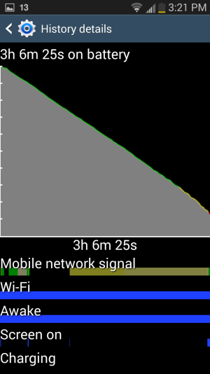

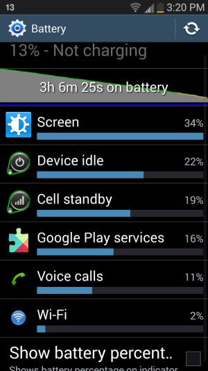

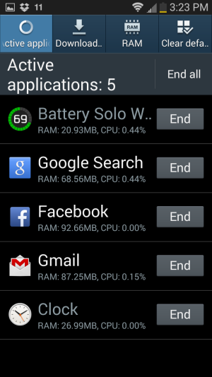

My phone has been getting slower and slower. And today, with the phone nearly idle, the battery went from 100 to 15% in three hours. The phone says it was awake for the entire three hours, but the list of active apps doesn't show anything unusual (see screenshots). As you can see, the Sprint signal wasn't great during that time, and that's not unusual either.
Where can I look to find the problem?
Any advice will be appreciated.

Your phone was awake for the whole time which is unusual in-and-of itself, particularly since even a weak cellular signal shouldn't cause the phone to stay awake the whole time. The 'Screen on' time was listed at 34% but you didn't capture that detail, so it's hard to tell how much that factored in (the Screen on bars in the History detail didn't look like that much).

Thanks, B., the reboot definitely helped. I'm sure that poor signal is part of the battery problem, as several of you have mentioned. I spend a lot of my time in downtown Chicago and near-north suburbs. The signal strength fluctuates a lot.
My phone also is running very sluggishly and I'm thinking about a factory reset.
Meanwhile, I'll try Gsam Battery Monitor. Even if it doesn't fix anything, it'll help me focus my anger in the right directions.
