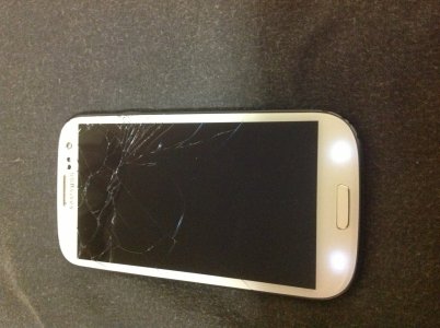

I've got sort of the same problem I dropped my phone and the screen is cracked it is not displaying anything on the screen however I can still answer phone calls and receive messages do I need to replace just the screen or digitiser as well?? Please help image.jpg
Did you read posts #18, #19 & #23? You need to replace the complete screen assembly.
