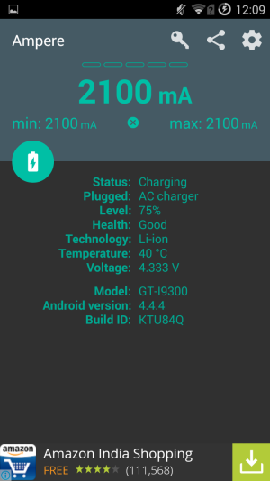

Galaxy S3 I9300 - Slow and inefficent charging problem.
I use nexus 9 cable with Samsung 2.1 ampere charger.
Also I turned the current to 2100ma using arter kernel..
It charges 0 to 100 in just 50minutes now
(2100Mah battery)
[Hide]Theoretically a 2100Mah battery is supposed to charge fully in 1 hour when charges with 2100mA current , but here there is also a increase in voltage (4.3V which is more than the stock 3.8V)
So
Power=VxI
(2100mah×3.8v)÷(2100ma×4.3V)=0.88h=52.8 minutes
Which actually matches the real value [/hide]
BTW battery can go insanely hot which may damage it so I use a external cooler to keep it down and I can't use it while it is charging.
