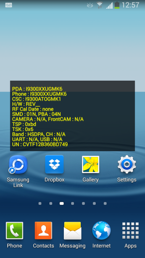

ok, im wondering if anyone on here can please help me, my phone has been fine since i got it last year, and yesterday it was in my pocket and i could hear it turning off and on but thought nothing of it, then when i took it out of my pocket later it had factory reset to german which it has done before, i'm guessing I must have pressed a load of buttons while i was sitting down, anyway, i got my phone on and changed the language to English, but this time was different to last time, i had no signal, I can only get the WiFi to work, i cant text or call or receive texts or calls to my phone, and all this text displays in front of the screen no matter what im doing! its driving me crazy, i've factory reset it twice since yesterday and it didn't fix a thing, so my phone is basically useless at the minute, if anyone has a clue what i've done or how i can fix it, id appreciate any help, thanks :'(

thanks a lot, and yeah i think my sim card works, i managed to download all my contacts from google and the little bars show up at the top of the screen as if im connected to a network but when i go into networks and search for providers it just searches forever, and i dont understand though :'( i havn't dropped it, it was just sittle nicely in my pocket :P
is it just greyed out with the actual IMEI in there or just blank? When mine failed the IMEI showed nothing, no numbers, nothing... that's when they said it had turned into a nice iPod. But if you have 'bars' maybe you just need some network configuration from your carrier? Have you tried using a different SIM card?
o yeah all the numbers are in there and stuff, its just grayed, dunno if its supposed to be, i honestly dont know what could be wrong with it, normally a factory reset fixes all of my problem haha :P do you have any idea why that message is on my screen too :( thanks again for your support :)
and no i havnt tried a different sim card, mine is jammed in there somehow :P i'll have to wait until tomorrow so i can buy a pin and pull mine out, then i'll try my friends sim card, so that fact that the IMEI is filled in is some good news then? :)
It's better news haha don't know if 'good'... Probably your phone is stuck in some service mode or something? Have you tried going into 'safe mode'? I think it's activated (with the phone off) by pressing and holding Power + Home Button + Volume Down until it reboots... I can't remember if it's Volume Down for safe mode and Volume Up for 'recovery' or the other way around... just try both.
