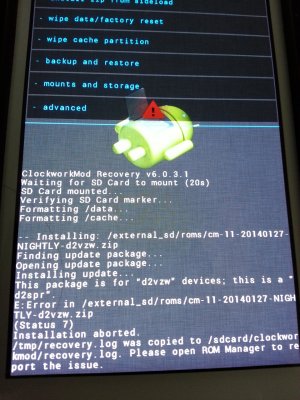

I bought a rooted gs3 on EBAY...
It is running liquidsmooth rom.. I have tried flashing some other VZW roms (esp. want to try out kit-kat roms) and I get an error during the flashing process..
See attached image...
Did I get taken on Ebay??? Not sure what I am doing wrong...
Thanks in advance for any help

Are you doing a full wipe before flashing the zips?
Wipe cache, dalvik cache, system and data before flashing any ROMs that aren't from the same devs or are a different android version

Yes, I think I am doing the full wipes.
But, what worries me is in the picture I attached:
"This package is for "d2vzw" devices: This is a "d2spr".

What carrier is the phone? You have to flash compatible ROMs. VZW ROMs won't work on Sprint phones and vice versa
Re: Rooted and now having trouble flashing VZW roms??
d2spr indicates that it's a Sprint phone. Shut it down and pull the battery and you should find the Model number there - doesn't sound like it's an SCH-i535.
If it's a Sprint phone the world isn't over - you can still flash ROMs, you'll just have to find the correct ones for that carrier.
