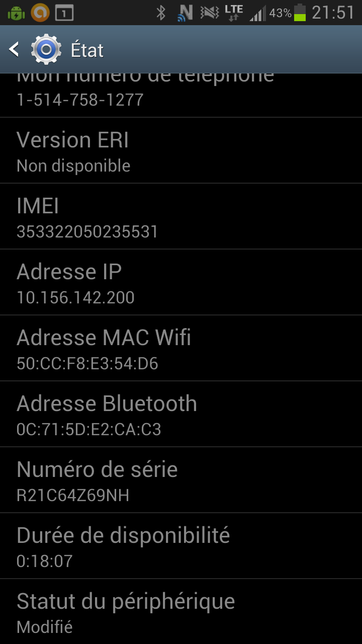

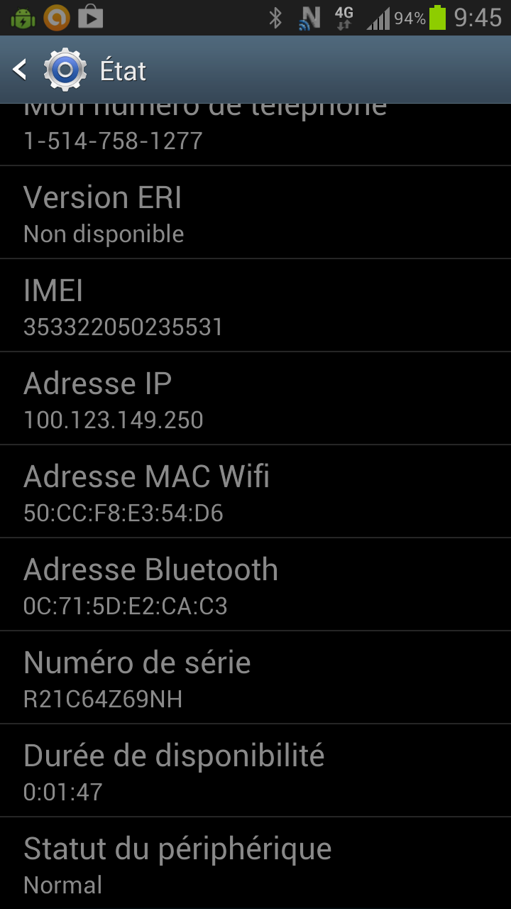

I have a Galaxy S3 purchased new which i had already updated to Android 4.1.1 ;
I now and then get that status "Device modified" and Samsung tells me that my waranty is void and I am no longer supported.
I never rooted my phone and never will ; This bug might have some serious economic impacts on the Samsung user community.
I tried the SD card removal, even removed the sim card ; the devices sometimes shows "normal", sometimes falls back to modified.
I cannot say that removing the SD card immediately restores the "Modified Status".
The two pictures included illustrate that the device shows "modified" and then shows "normal" a few days later and will probably
show "modified" in a few days...
Do we know if Samsung is looking into this bug ? Will it be fixed with Android 4.2.2. ?
Will we be able to upgrade to 4.2.2. (via Kies?) if we are in one of those "modified" days ?
Is Samsung going to recognize the bug and not void the waranty based on the fact that users have NOT rooted or modified their phone ?
Normand
