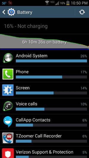

Hi. Since kit kat upgrade the battery life is totally reduced. 1% per hour without use and 20% per hour with internet or phone use. All backgrounds reduced. Use of the excellent gsam application. Any idea before switch to next iPhone?
I would charge my battery overnight to 100%. 4 hours later the battery would be at 10%. This has only happened in the last 2 weeks. My phone would also be red hot after charging After reading other forums I have done the following
