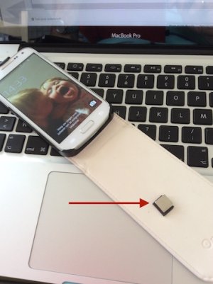

Due to water damage the Samsung Galaxy 4 Mini of my daughter couldn’t be turned off to sleep. As soon as you turned off the device it went on again. Cleaning the inside - like suggested on numerous web sites - didn’t help. Neither did the advice given on this web site. By some coincidence - I was installing an SSD in my MacBook at that time - I found an easy solution. I only had to put a magnet on the screen at a specific place. After some experiments, I put the little magnet on the inside of the flip cover of the mobile phone. The phone is now working just like before.IMG_0209.JPG
