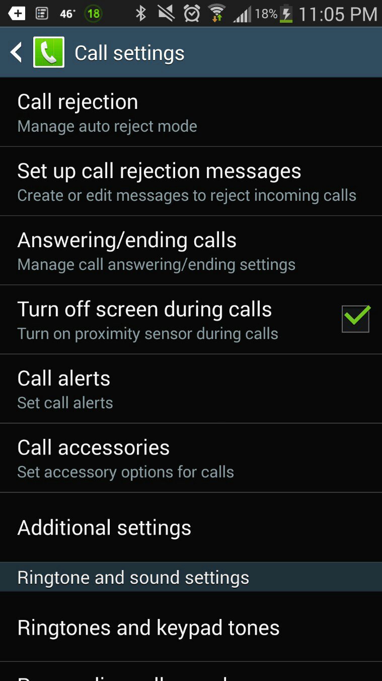

Go to
Settings
My device
Call
Make sure the the option "Turn off screen during calls" is checked.

Thanks for the reply. It is checked however.

Uncheck it, pull the battery out. Wait a minute, place battery back and turn the phone on.
Go back to the "Turn off screen during calls" feature and turn it on.
See if that helps.
