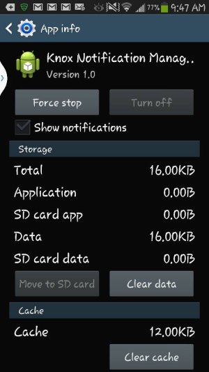

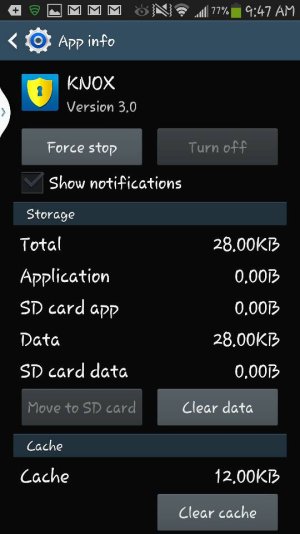

If you pull down your notification bar and hold down on the notification when you receive it you'll see that a button pops up and you can hit app info. This works for ALL notifications in Android. It will show you what's causing that notification... And know what it is? I highlighted it below in the screenshot... It's called "Knox Notification Manager".

You don't need to force stop it, just un check the box "Show notifications".
Two examples below.

My KNOX screens are exactly the same as what you see in YOUR screenshots. The "Show Notifications" is grayed out and there's no way to turn it off. I am not rooted BTW, but will be soon...
I'm not rooted either, and if you have the same as my screenshots than you have Knox off.
