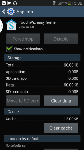

Actually, I retried this and don't have the ability to force stop. That is ghosted out as an option. Do you have to be rooted to do that?
Again, the only people that I've seen who have defeated this keeping the update are those who rooted their phone and deleted the TouchWiz easy altogether. My phone isn't rooted though and my prior rooting attempts failed.

Hi iiari
Not sure why you cannot 'force stop' TouchWiz easy home, though. And my phone is not rooted version, still intact and as original as it was since I got it ;)
This is how it looks like on my phone once I forced stop it. Strangely, it does not get into "Disabled" category on Application Manager. Perhaps compare your versions with what I have just to see if they are any different?
TouchWiz easy home version 1.0
TouchWiz Home version 4.3-I9505XXUEMJ5
Google Search version 2.6.7.721924.arm
My Google Search has been enabled and did a couple of reboots with no sign of problem re-occurring which make me a happy person! I intend to proceed with the update on Google Seach and see how it goes.

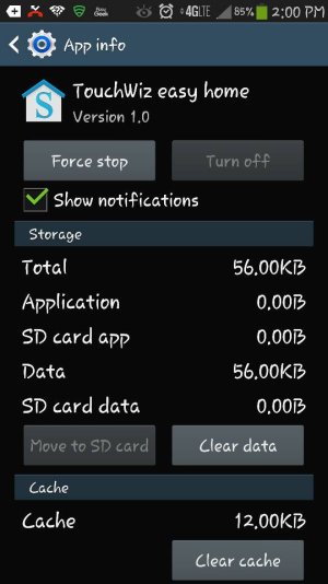

Hello.
I'm also with Sprint and don't have that problem. Do you have the option to Force Stop the app as in my screenshot?
If you do try to force stop it see if that works.
