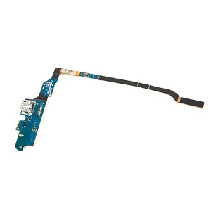

Joora, I know this happened to you a long time ago , but can you specify what part they replaced ?
Is the flex cable of charging port(see the picture)?
