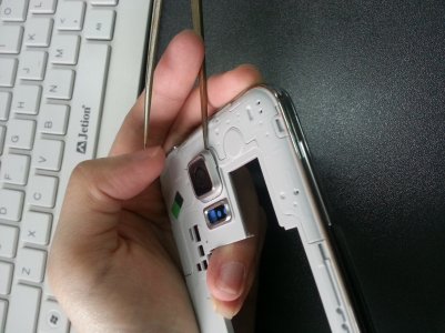

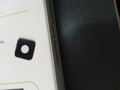

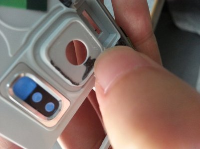

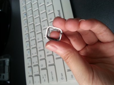

I removed the camera lens from my midframe replacement and found it's not an easy task, but not point to remove but install. Not only need an original camera lens, if you want to keep it waterproof, also need some adhesive felt pad and sticker. I will show the pictures.
Then found there are two kind of adhesive, outer one is transparent, the other inner one is black.20140505_110636.jpg
That's the adhesive felt pad with strong adhesive, but i had removed almost, you can imagine that that place full of black adhesive felt pad except the center.20140505_112747.jpg
And now can see the real face of the camera lens. You can see that the edges of black paint had been damaged by tweezers when pry the lens.20140508_123600.jpg
For now, the market doesn't have all the adhesive for replacing camera lens, so once you broken the camera lens, either send to Samsung or wait until you can find all the adhesive.
