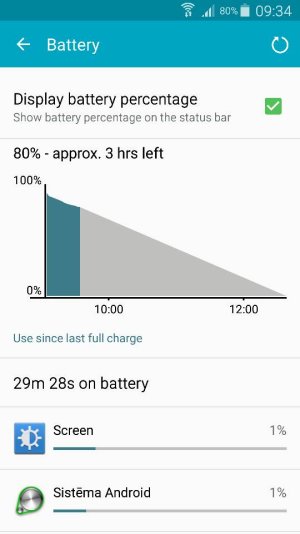

Please help! I'm from Latvia and I got phone from South Africa CSC region XFE. Battery is hugely draining and I tried to downgrade to kit kat. That helped, but apps were crashing and stuff. Battery was only a bit better. Then it was 5-6 hours uptime but I love the lollipop design. So I upgraded it trough kies and waited for the best. Battery was 3-4 hours. I rooted it and downloaded wakelock detector and greenify. That helped 4-5 hours. I know that I should get a new battery and consult the ****sung. Here's a screenshot

Please help! I'm from Latvia and I got phone from South Africa CSC region XFE. Battery is hugely draining and I tried to downgrade to kit kat. That helped, but apps were crashing and stuff. Battery was only a bit better. Then it was 5-6 hours uptime but I love the lollipop design. So I upgraded it trough kies and waited for the best. Help
I believe your phone model is the G900H, non 4G, octa core model, XFE, for South African networks. This could be causing signal issues on the European networks, resulting in battery drain and over heating.
