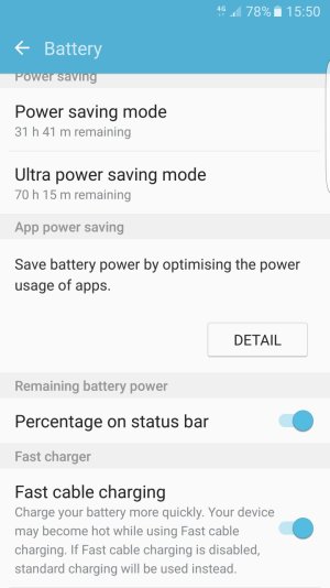

The option to select fast charging is in settings>Battery and is the last item. Are you saying this isn't visible on your device?

Hi thanks for replying ..no its on in the settings but when i charge the phone it just says cable charging and taking ages wereas before it would say fast cable charging if u get me
Yes, I understand. My S6 Edge shows cable charging and fast charging on my home screen swipe down depending upon which cable I'm using. I can't get my head around whyScreenshot_20160927-155002.jpg you don't have the option in settings like this
I do have it in my settings and its on but when i turn the charger on the phone says charging where it used to say fast charging and charge my phone very quick now its only saying charging and taking ages

Thanks pugs for your help really appreciate it ..its in the wall socket ,another thing i want to ask you when i go into the phone settings battery and fast cable charging its saying its on with the blue light with no charger in place but if i connect the charger the blue light goes off???im so confused with it ,this all happened when i updated the phone a couple of weeks ago
That certainly shouldnt happen. Try wiping system cache. Sometimes following a major update gremlins get left behind. A factory reset is generally recommended but i regard this as a last resort. A cache wipe wont affect your data.
